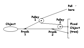

Thanks for organising a great night Shane. Could you throw up a diagram of a Z-drag so that those here can visualise it?

- Shane_Desmond
- Posts: 283
- Joined: Wed Sep 09, 2015 11:21 pm
Z drag diagram
